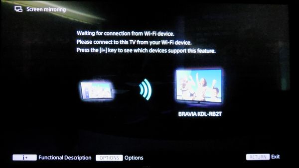

Step 1 - Set your TV to to "Screen Mirroring Mode" :

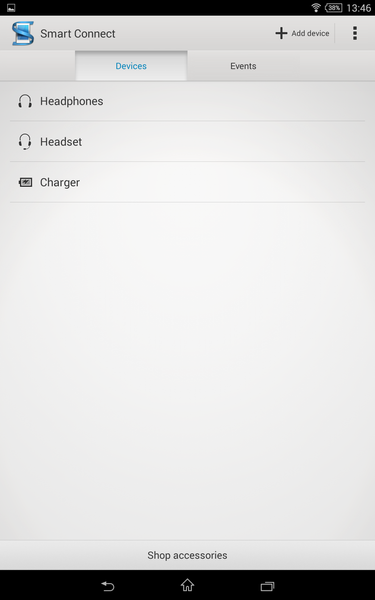

Step 2 - Run the "Smart Connect" app on your Tablet and tap [OK] :
Step 3 - Tap the "Devices" tab at the top and tap "Add Device" :

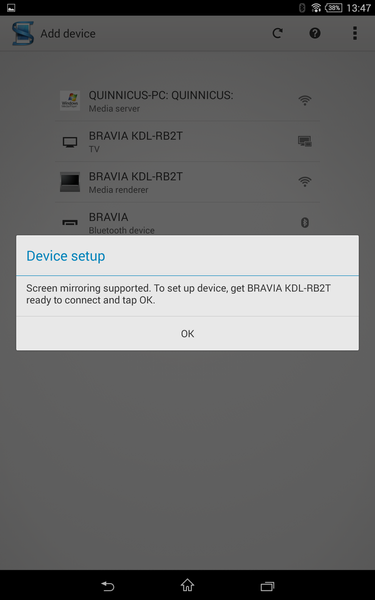

Step 4 - Tap [OK] :

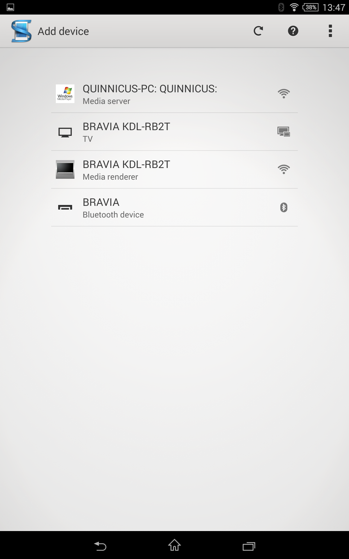

Step 5 - Tap on your TV to select it, Ensure its (TV) and not the media renderer :
Step 6 - Tap [OK] to setup the device :

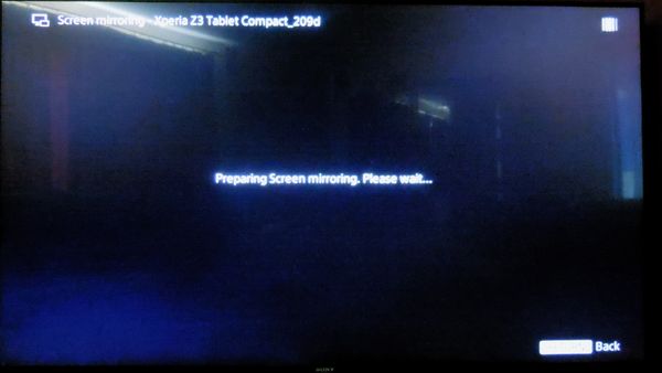

Step 7: The Tablet will then attempt to connect to the TV.  On the TV, click on [Accept] with your remote control :
Step 8: The TV and Tablet will now connect with a short "Preparing message on the TV" :
Sucess !  :grin:
