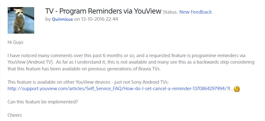

I know the 2015/2016 Android based TVs no longer have the reminder function.  It seems that the non-android based TVs have also had this feature removed.  I have had a look at the manuals associated with this TV, and there is no mention of this function - whereas on other years models, it was mentioned in the manuals.
I have already forwarded a request to Sony in regards to Android TVs having the reminder function implemented:
I have added a comment to my original request to see if they can re-instate this function on non-android based TVs too.  If there is a call for it, im sure it can be done via a future FW update - the YouView issue above is different however, so ignore that part.
