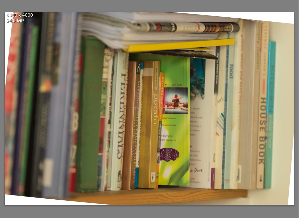

My A99 has suddenly developed a new feature! Any image captured in RAW is now skewed. By skewed I mean it has rotated 3.5 degrees in a clockwise rotation leaving the canvas around it white... I have checked for the issue using JPG format and no issue so it only happens on a RAW capture and in both vertical and horizontal orientation.
Does anyone have any idea why this is happening? Have also tried a range of different lens and get the same issue.
see examples:

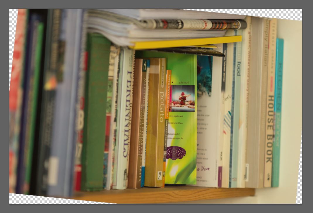

Switched format to RAW + JPG - see attached. Raw file rotated 3.5 degrees clockwise and JPG perfectly ok -

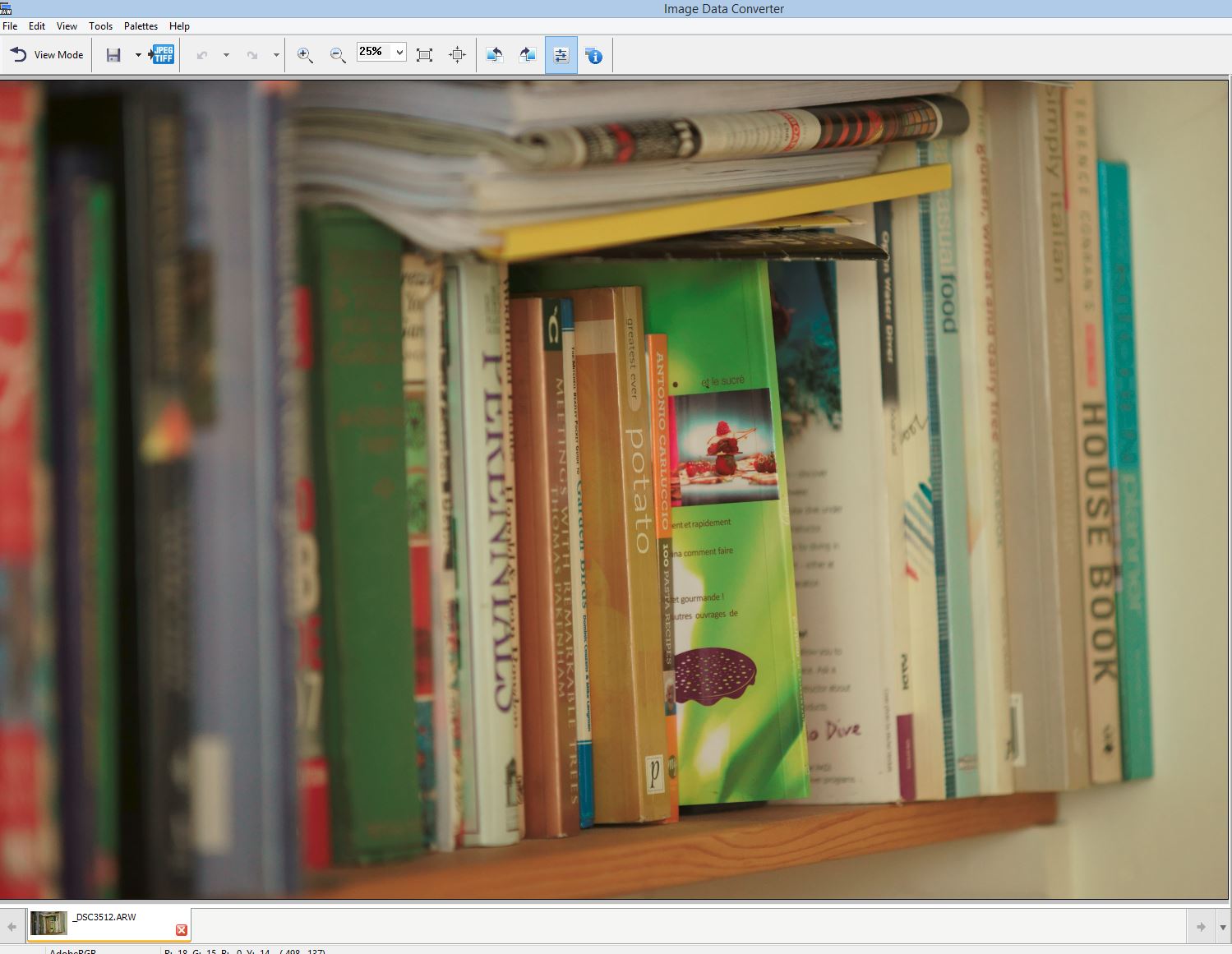

1. Opened RAW image in IDC and it looks fine - horahh
2. Opened Raw image in Photoshop CC - it's skewed
3 Opened RAW image in Lightroom 6 - it's skewed
Conclusion - Adobe has changed something with their RAW converter which means A99 RAW files get skewed clockwise by 3.50 degrees
