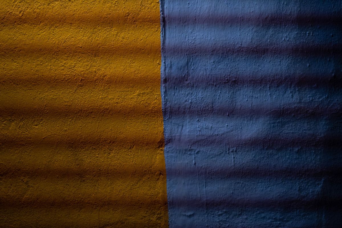

I recently bought an A7iii and am having problems with low light photography. I know it's not the lens as I've tried with different lenses and the same thing happens. I get a brown banding across the image. I've tried all sorts of different setttings and it seems to happen with all of them. Is this a fault with the camera or is there something I can do to sort it?

You don't mention camera settings or lighting conditions, but this sort of issue is more often than not a combination of certain light sources and the Silent Shutter setting on the a7iii.
Can you check and see if it's still happening with Silent Shutter (or EFCS – Electronic First Curtain Shutter) switched off?

Yes, i think this was the problem. I didn't mention settings because it happened on so many different settings. But I've just read an article on the web that suggested one way to avoid it is to set the shutter speed to 1/125 and I looking back at previous photos I notice that although there is still some banding at that speed, it's much less noticeable.
I've now tried turning off the silent shutter as you suggest and that does seem to sort it.
So, glad I've found a way around it - just sorry that I've lost several evenings worth of shots on the way! The problem is that it doesn't show on the viewfinder, so you don't realise until you're looking a the photos later.

@shines01 That's a shame, losing so much work, but at least you have a solution now. That setting really doesn't have much practical use, so you can safely leave it off – or if you do need to shoot silently for some reason, use a 'clean' shutter speed.
