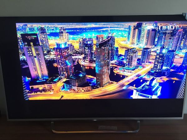

1. Videos not playing in Full Screen in the native 'Videos' app.
Description:
Videos sometimes appear on the top right corner or sometimes in the centre at a smaller display size. Here's a picture of what I mean:
The videos are in native UHD resolution (3840x2160) in the .TS format with HEVC codec. Have also had problems with UHD videos in .mp4 format. The problem seems to occur mostly with 4K (UHD) content. These are all videos being played from a USB 3.0 stick plugged into the USB 3.0 port on the rear of the TV.
Rebooting TV or killing the app does not seem to solve the issue most of the time. Issue appears most of the time, though not all the time. Did not have this issue at all with the previous software version and is definitely down to the recent software update.
