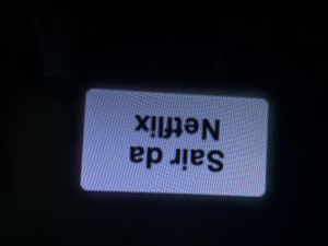

Getting upset with this Android TV sharpness thing.
Tried changing interface resolution with Android SDK to 3840x2160 and DPI 640 (instead of 1920x1080 and DPI 320) but the sharpness is still not there. Also tried 1080x1920 like the FireTV has with no luck, it changes resolution but no sharpness.
This sharpness thing affects Android UI and Apps, so I think this might have to do with TV settings and not Android.
Here are some screenshots of FireTV Netflix through HDMI vs Android TV Netflix built-in. Both running Android 5+.
FireTV on the left, Android TV on the right.
@frogger38 Thanks for your replies anyway, all helps to confirm I am not actually going out of my mind
@sonybox wrote:This sharpness thing affects Android UI and Apps, so I think this might have to do with TV settings and not Android.
The set is designed (optimised) to show moving video at particular frame rates; it's not really a graphics/computer monitor - which would be designed in a quite different way...
Additionally; there is actually no reason to suppose that the UI graphics themselves will be of 'full UHD quality'. DPI settings are irrelevant since you're dealing with an absolute-bitmap. - i.e. you're not resizing vector graphics.
It's not uncommon (for instance) for captions from broadcasters who should know better (STV are particularly guilty!) to be of such absolutely dire quality that they would have looked 'bad' at SD let alone HD or UHD!
~ I am HIGHLY critical of these sets in terms of some very basic flaws that affect their primary use as broadcast receivers... But, in my professional opinion there is little or nothing wrong with the display quality relevant to the class of equipment/price. - They would not be out-of-place as studio floor monitors.
Incidentally... As hard as it is to discern frm your photographs, the apparent 'sharpness' of your other device looks to be as the result of some degree of artificial 'edge ringing'; back in the old days of VHS and CRT sets, this was a common 'trick' performed by certain so-called 'video enhancers' - it's not really any sharper; it's simply taking advantage of a facet of human physiology to provide that illusion...
Unfortunately it does that by 'trading off' tonal subtlety - fine on a simple static graphic; but not how a cinematographer would intend their pictures to look.
