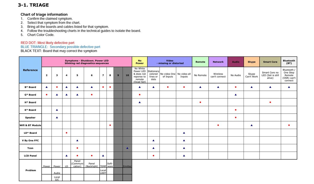

this chart applies to 2015 models and it states it no hardware error and my involve main board or wifi module.
robert1881
Thanks for this chart, it looks like a wifi or main board issue, hopefully can be repaired once the servicing company re-opens.
Step 4 in the chart talks about isolating the board, but I don't have any instructions on how to do this.
