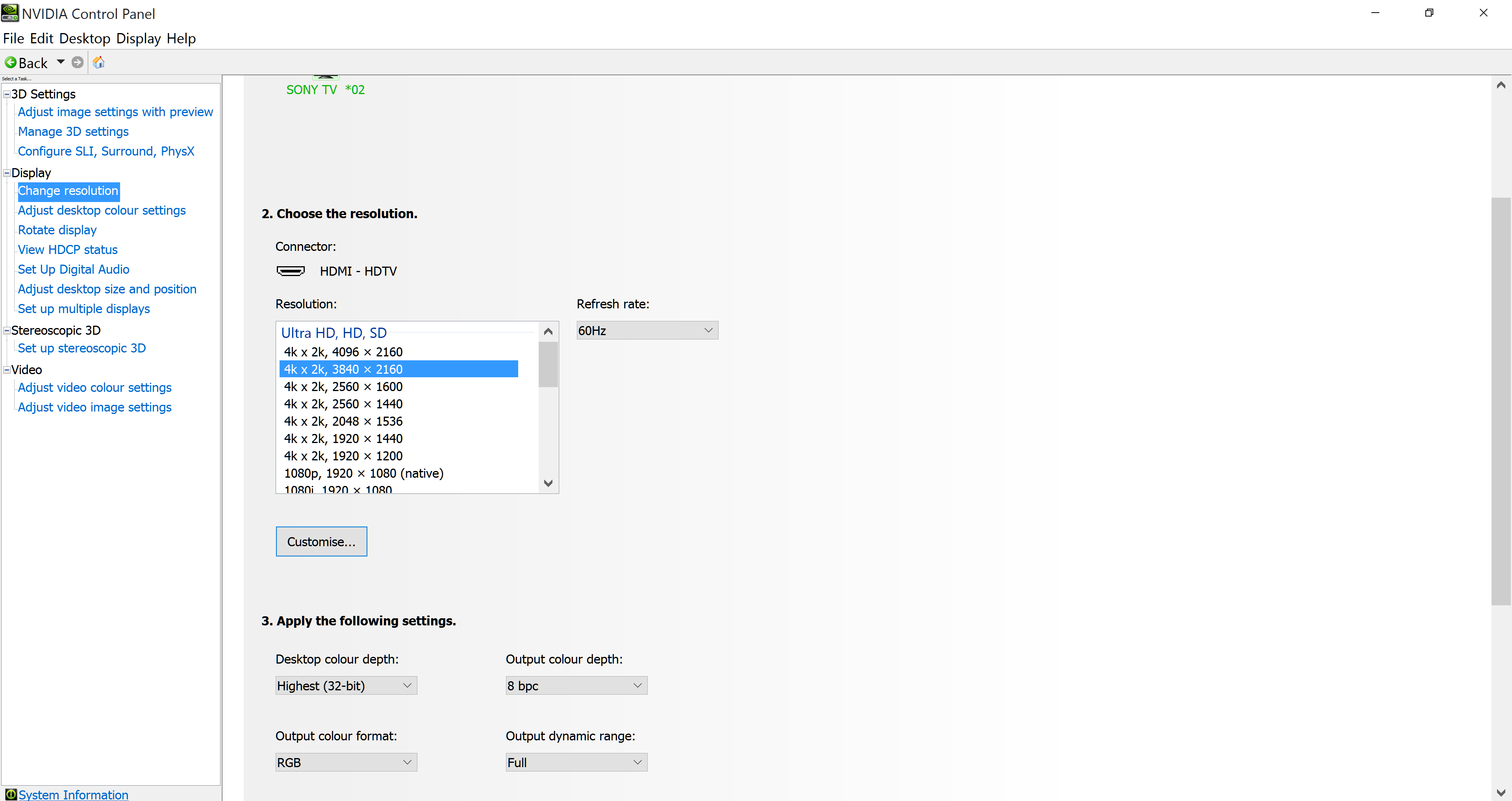

Here are my settings in Nvidia Control Panel but I'm sure these are what you tried :
