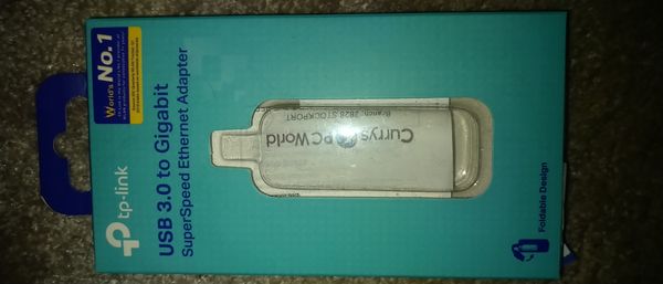

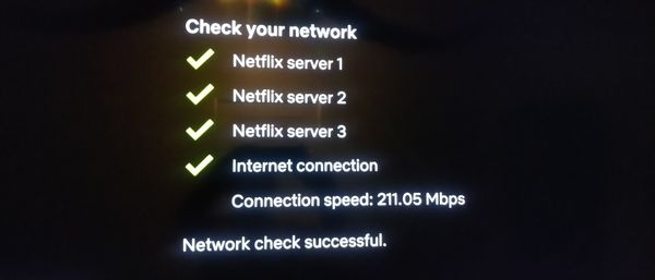

Hi I had the issue when I got the TV XR65X94J And found that the built in ethernet was capped to 100mbps, but still had the issue when using WiFi. I got a USB 3.0 GIGABIT superspeed ethernet adapter and since the last update everything seems to be working OK.
Would this Help you? 🤔 I has seemed to of helped me as it allows a stable wired connection not limited by the built-in ethernet. Test done on Netflix speed test.
I am using Bravia Core with pure stream turned on. Hope this is useful.
