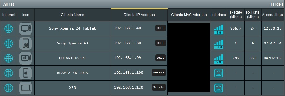

However, if I look in my router devices list, it will only list the TV once - therefore the Remote device/Renderer option on the TV is adding two instances for this.
