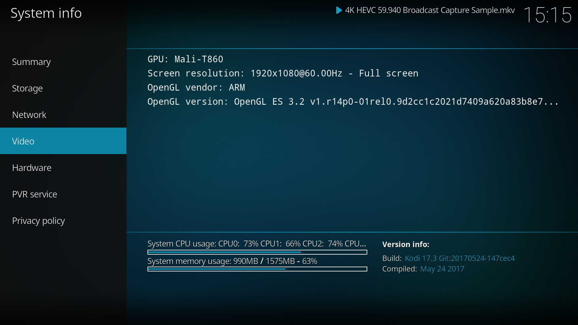

@Kuschelmonschter Sorry to bother you again.. but how exactly would you show the fps in Kodi? Not that it really should matter, I am very positive that the refresh rate is 60 Hz.Go to Settings > System Information. The value is read via Display API (see methods getMode and getRefreshRate).
Do you mean this (the 4K video is playing in background. It just doesn't show in the screenshot)?

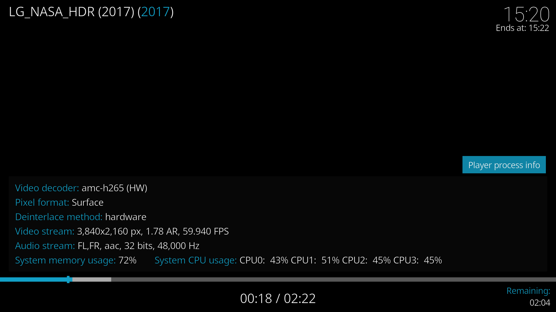

Apart that it is wrong, it shows 1080p. I had this issue since ever with Kodi, I have never managed to see 2160p anywhere. Otherwise, pressing "o" with a "BT keyboard" (not really. I use "Typeeto" which turns my Mac into an BT keyboard. Very neat! Recommended to @Anonymous !
) I get this:
But I think that actually shows the media info, not what or how it's really playing. At least for the Video Stream part. I see indeed that disabling the HW acceleration the videos stutter but it still shows 59.940 FPS.
'O' shows you the properties of the source material, not the display.
Android and all app GUIs are rendered at 1920x1080 on Sony. That's why you see it everywhere. A 4K GUI would just not be feasible on the weak MediaTek SoC. It later gets upscaled to 4K. The video pipeline is a different path. So you can decode and render a 4K video via MediaCodec Surface while rendering the GUI in 1080p. That's what Kodi does...
