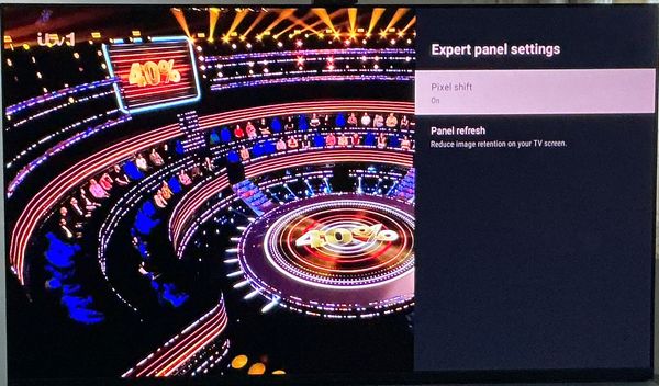

You may also have Expert Panel settings under Settings> Display & Sound, here you can set Pixel Shift to ON, and also run Pixel Refresh, Sony recommend only doing this once a year.
The TV may run its own calibration after being turned off for a couple of hours, my TV does this.
After the TV has been put into Stand By it will recalibrate the pixels after a few hours, it does this in the background without having to switch the panel back on, this should keep burn in at bay.

Press Settings on the remote, Settings on screen> System> (scroll all the way down) Retail Mode Settings click right and switch Demo Mode On, this will also switch Picture reset on, more of that later.
Power the TV down and unplug the TV.
Wait about 30 seconds and plug the TV back in.
Power on the TV and wait about 2 to 3 minutes.
You should then see a grey box asking you if you want to start the pixel calibration, press Start.
The panel will switch off and begin the calibration, this takes about 10 minutes, be patient..
Keep being patient, it looks as though nothing is happening but it is.
When done the panel will switch back on.
Repeat this process 3 more times.
Switch off Demo Mode.
Because Picture reset was switched on then you will now have to go into the Picture settings
and change them back to what they were before you performed the calibration, so make notes
beforehand. Unfortunately you need to do this for all other devices you use with the TV which
are connected via HDMI or USB.
