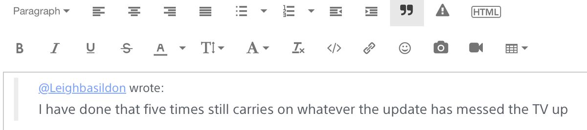

Hi @Leighbasildon   Unless you quote the post you are replying to, it doesn’t make any sense.
