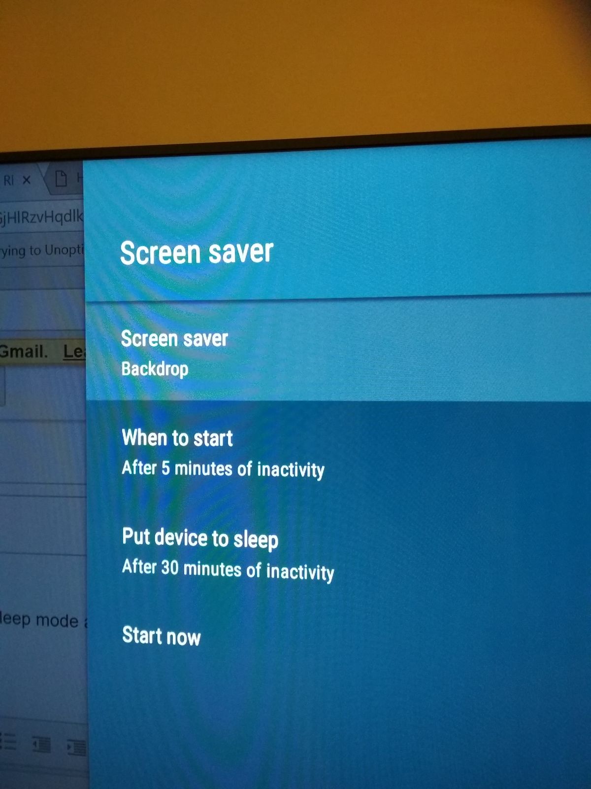

When I launch the default screensaver manually from menu options: Home-Settings-ScreenSaver it does work but never starts automatically.
I set screensaver after 5 minuts of inactivity, sleep after 30 minuts. When PC is down or there is no input on any hdmi or analog ports I get message No Input Signal, port name, clock etc. TV displays this message forever and the panel leds are ON.  I'm not using timers at all. For years I never shut down monitors, printers, subwoofer, etc. There is automatic sleep preconfigured on any devise I used for years. It seems totally bizarre to push power button every time to switch ON/OFF TV in 2018!

Yes, I disconnected everythig: PC, Receiver, Wi-Fi, moved mobile phone to another room, pooled out battery from the remote. Nothing helps.1.jpg22.jpg
