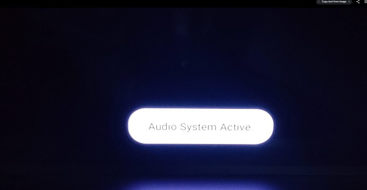

Sorry should have mentioned that I am on the latest firmware.  But what happens is when I am watching something from HDMI, for example I have my sky q box connected to HDMI 1 and PS5 connected to HDMI 4. When I turn on the sondbar, the screen goes black.  While it is black a toast message says Audio System Active for a second or 2 then the picutre appears again.  I also go high end 8k hdmi cables with ethernet as well.  Same thing.  I have an official Sony HDMI cable plugged into the sub and into HDMI 3.  I have HDMI 3 configured as standard.

After that message appears, the screen comes back on again after a second or 2
