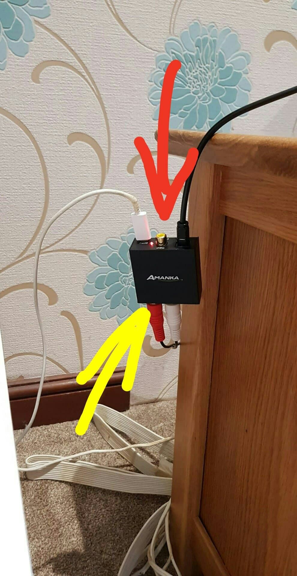

There you go..the adapter box in using .....
