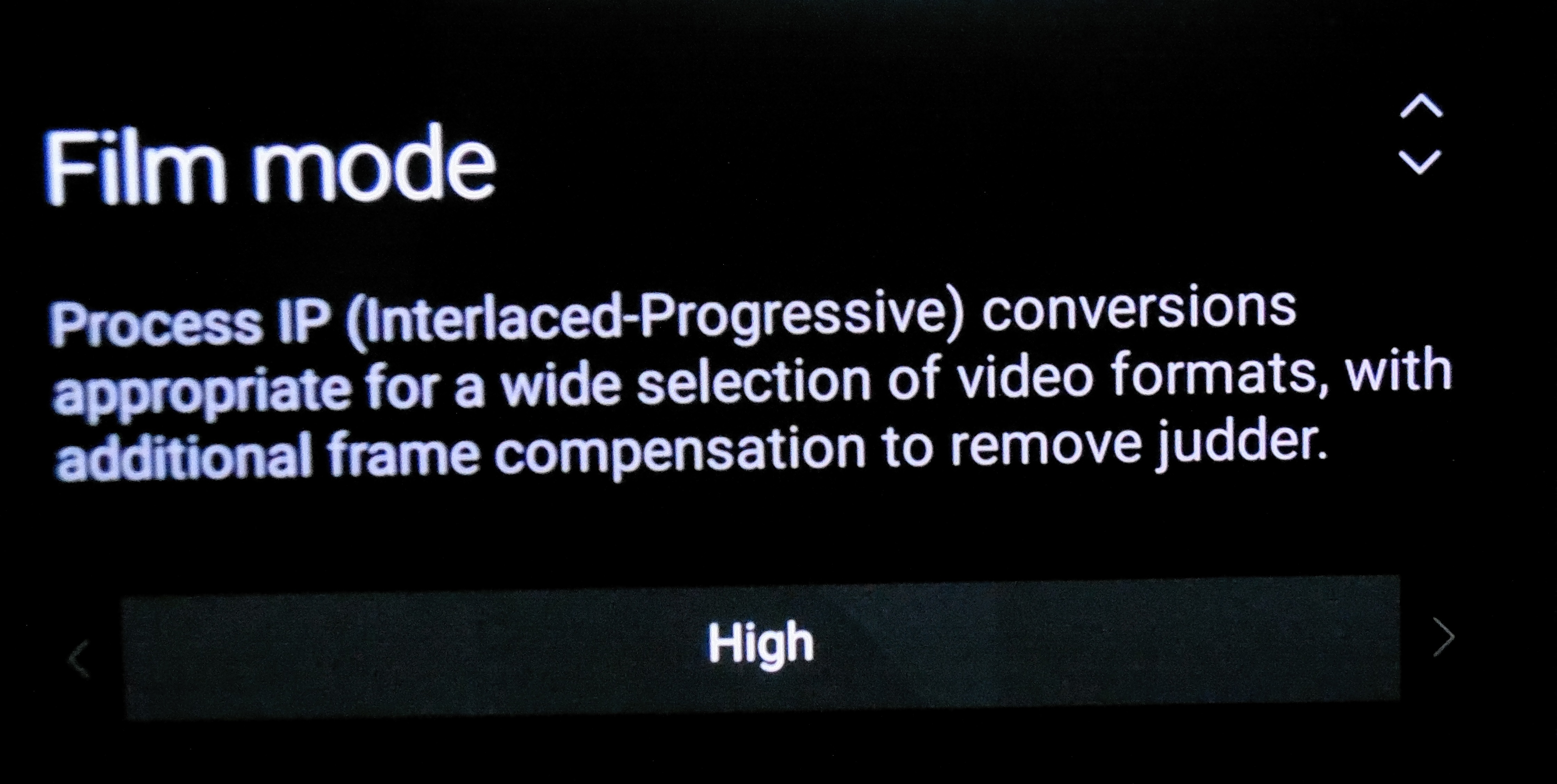

This is film mode:

With KD43XD8305 and Maxtor M3 1TB portable drive, I have now tried the suggested high setting in Film mode. At first, this made no difference, until I discovered that Motionflow must not be set to "Off"! I don't consider it obvious in the Advanced Settings that Film mode is an attribute of Motionflow. Is there a detailed explanation anywhere of what these settings actually do?

I should have said, with Motionflow at Standard and Film mode High, the gross judder in USB playback has gone. Playback of Freeview HD now seems indistinguishable from off-air, but I would like to understand why these settings are needed only for playback.
