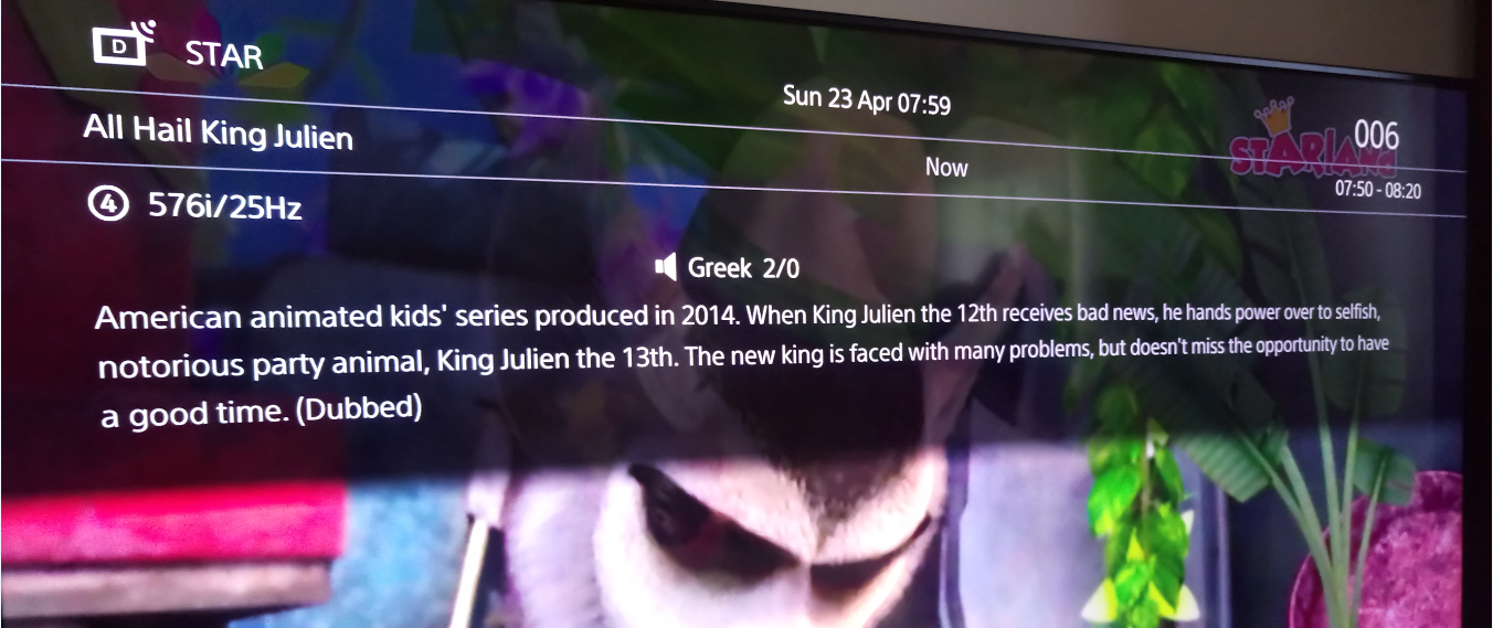

Hi Quinnicus
This is the issue.
Current program All Hail King Julien info until the word (Dubbed):
Press right arrow on RC should give next program Transformers Rescue Bots info:
But as you see title changes normally but description is added below previous. After the word (Dubbed).

I can confirm this for Croatian channels also.
But It's not that it doesn't go to the next info. It does. It's just that it doesn't delete the previous one. So if info on current program is very short moving to the next with very short info will result with both of them being shown.
If the first one is long then there's nothing from the second one.

Hi @kinggo01
This is exactly what happens to me too. You can see this on above pictures. I also use the "down" arrow on Remote Control to see all information for Next program.
But this did not happen on previous Android 5. Next program info was separate.
