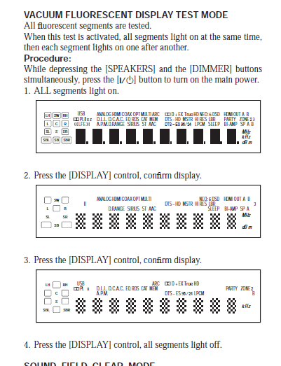

I had a quick look at the service manual and tbh I suspect this will be a genuine fault... a component failure. The display is a VFD (Vacuum Flourescent Display) which are generally very reliable, however there is an auxilliary circuit that derives and generates the necessary  voltages needed for these type of display. That would be the first area to look at.
There is a 'Display Test' routine that you could try although I suspect it will not do anything.

Thanks - I'll give that a go.
