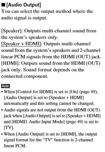

Hi there
Looking in the manual:
You must set the Audio Output on the bluray player to "Speaker + HDMI" - however it also states that "Audio signals are not output from HDMI (OUT) jack when set to Speaker + HDMI and "HDMI1 Audio Input Mode" is set to TV" - So ensure its set to HDMI1

Hi there

Perfect, thanks so much for your reply!
I stumbled across the solution by re-routing the HDMI connections between the TV and the Blu Ray player. Originally I got picture but no sound when running from Blu Ray to TV on HDMI 3 (ARC enabled). I switched to HDMI 2 on the TV, with the same results. Then I switched to HDMI 1 and it worked.
Thanks again!!
