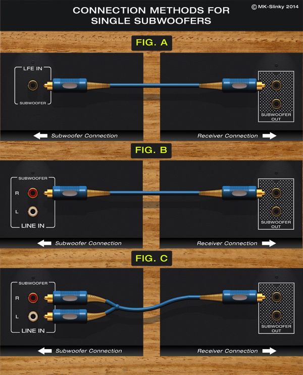

Single Subwoofer
  1. If you have a Subwoofer-Out port on your AV receiver, and an LFE port on your subwoofer simply connect a subwoofer cable between each port (see Fig.A).
  2. If you do not have a LFE connection on your subwoofer, you would more than likely have an L+R connection (Left and Right). You can connect a single subwoofer cable between the subwoofer-out on your AV Receiver to either the left or right connection on your subwoofer. (see Fig.B)
  3. If your subwoofer permits, you may be able use a splitter cable to connect the L+R ports on a subwoofer to a subwoofer-out port on you AV Receiver (see Fig.C)

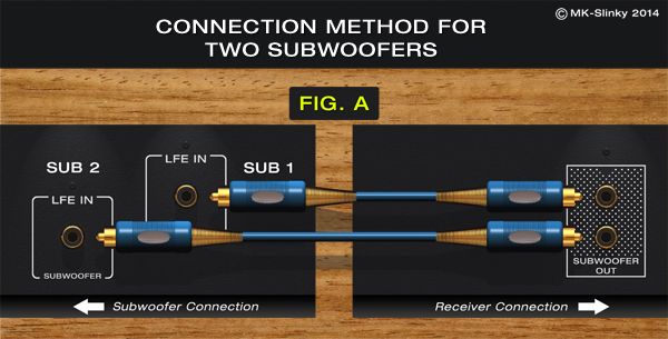

Twin Subwoofers
Many AV receivers can handle two subwoofers, which when placed correctly this can give a more even bass effect in greater listening positions instead of “the sweet spot”
If you have two sub-out ports on you AV receiver and an LFE port on each of your subwoofers, simply connect a subwoofer cable to each of the sub-out ports and LFE ports. (see Fig.A below)
