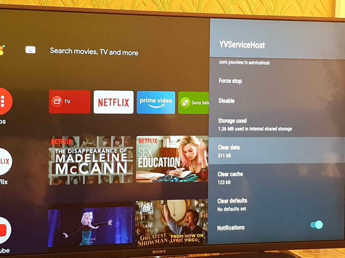

I had this problem along with an issue that the ITV app would not show the ITV programmes.
Did the below and sorted both issues...Click apps in menuClick apps in menu
Scroll to very bottom and select YVServiceHostScroll to very bottom and select YVServiceHost
Click clear data and clear cacheClick clear data and clear cache
