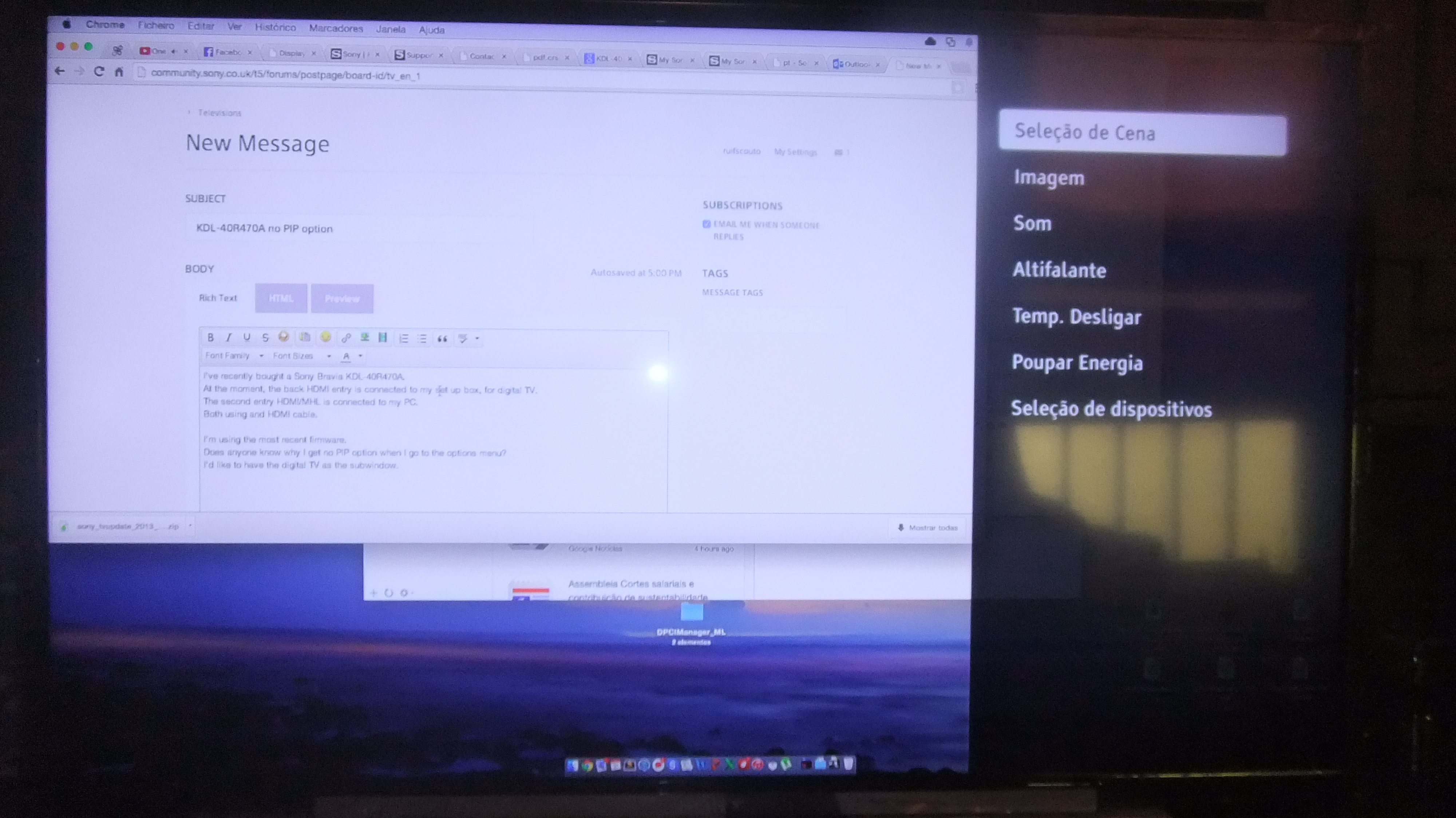

I've recently bought a Sony Bravia KDL-40R470A.
At the moment, the back HDMI entry is connected to my set up box, for digital TV.
The second entry HDMI/MHL is connected to my PC.
Both using and HDMI cable.
I'm using the most recent firmware.
Does anyone know why I get no PIP option when I go to the options menu?
I'd like to have the digital TV as the subwindow.
The options that are shown are:
(from top to bottom: scene selection, image, sound, speaker, shutdown timer, power saving, device selection).
According to the manual the TV does support PIP.
Thanks to anyone that can help!
Solved! Go to Solution.
I think I solved this one myself.
The user manual must be the same for an entire segment of TVs. When reviewing the actual TV specs I now see it does not support PIP functionality.
