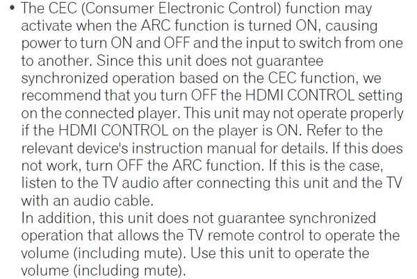

Hi there
Just going to summarise things up here:
In the manual for the AMP, it states:
This is one of the biggest problems with HDMI-CEC - it was supposed to be a standard, however each manufacturer seems to be implementing it slightly different. Sometimes it works, other times it dont.
I believe so. However its confusing, as why would turning it off on the TV make it work. Its possible that there is a signal conflict, and the way Pioneer have impletemented CEC functions.
No harm in trying though
If it makes no difference, turn it back on again (on the TV) and if there is a setting on your Sat box, try turning that off. (and combinations of the TV as well)
