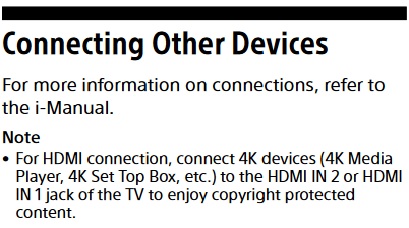

Im at a bit of a loss to be honest.  Ive dug a bit further and cannot find anything thats out of the ordinary.  As far as I can see, it should work on 8bit (10bit it wont, see pics below)  For example:
- Both HDMI cables are compliant (the IBRA is rated for 18Gbps and 2160p@50/60hz)
 - According to the manual HERE:
So what I am going to do, is flag this thread to Sony Support for them to help you.  Unless another forum member can assist in the meantime, Sony should be contacting you either Monday or Tuesday next week.
