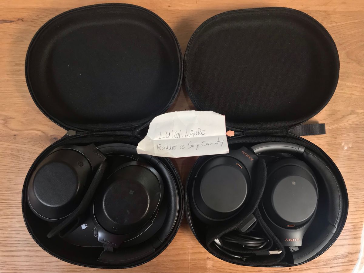

luigi.lauro
Experiencing exactly the same, I can 101% confirm.
Issues related to firmware 4.1.1 on Sony 1000xm3:
  • 40-50% less noise cancelling effect (very noticeable on voices) [!!!]
  • Battery usage seems higher (battery drains much faster)
  • Possibility to disable voice notifications, which is a big improvement, is implemented in a very stupid way (e.g. it disables also pairing & battery level voice feedbacks)
  • Background rumours are piped back in the headphones from external microphones whenever a call is made, even with ANC turned fully on (very easy to test, just turn ANC on, and then place a call... immediatly as you hit the 'call' button, before even the call connects, you will start hearing background noise similar to when the "Ambience" mode is turned on. Close the call and the ANC will instantly kick back in) [THIS ISSUE IS NOT NEW AND WAS PRESENT ALSO WITH PREVIOUS FIRMWARES]
For me it was very easy to confirm because I still own my MDR-1000x and I use the 1000xm3 in the office & while travelling around, and 1000x usually at home for convenience, since ANC needs are less extreme.
Before the firmware update there was a significant ANC performance gap between the two headphones, which I tested several times at home (when kids got too noisy, I switched over to my new 1000xm3 exactly for the improved ANC performance and muffling of voices). After the firmware update, in a side-by-side test by putting and removing the two headphones quickly one after the other in the same environment (house with TV turned on & kids speaking in background), my old 1000x performs much better than 1000xm3 especially on voices, which was not the case before the firmware update.
I tried everything to fix to no avail, specifically:
  • Activating / de-activating ANC/Ambience, and moving the slides from 0 to 20
  • Resetting settings
  • Factory reset of the headphones
  • Letting them die out for battery 0% and then charging back to full
If this situation will not be remedied in a short time (either firmware downgrade to previous one, or new firmware fixing this issue), I will 101% be returning them, since they instantly became worse than my 1000x.
As a proof of the 'comparisons' tests I did to confirm the issue, I attach a picture of my 2 sony headphones (had also xm2, but sold them after buying 1000xm3).1000x & 1000xm3 side-by-side1000x & 1000xm3 side-by-side
