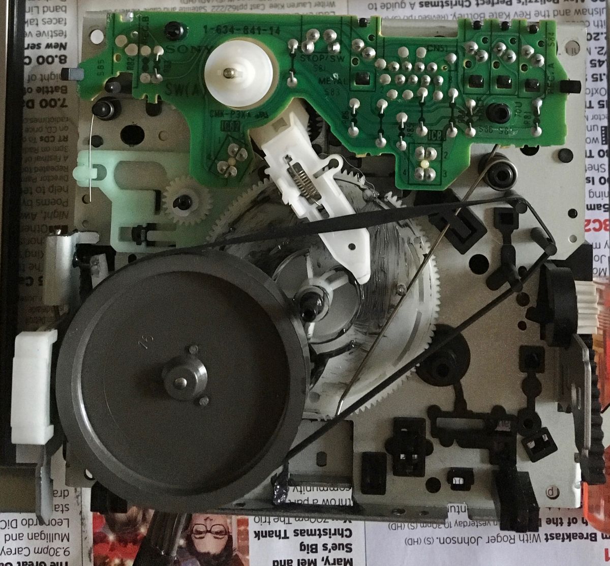

Disassembled the mechanical unit, separated the motors from the main frame, for a closer look. The capstan belt is very slack! Apart from that I can't see anything obvious, can anyone here from the picture please??

Blencogo
Expert
That looks like it could be the problem. I don't know if the gap is as designed but I suspect not.

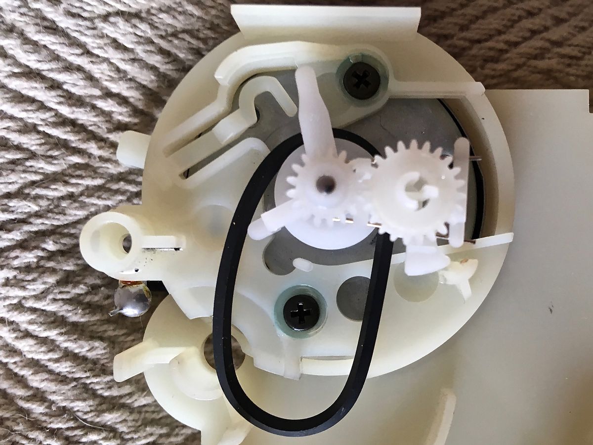

IMG_5439.jpgI also noticed this wavy thing coming off the bkig geara wheel? Wonder if it's a spring thats stretched or something - needs looking at!!
cheddarman
Member
Opened up again, no sign of a cracked gear on the spindle motor.
Also, the "wavy thing" has gone from the big gear wheel, probably a dog hair!
Looking at the big gear it has several gaps in the teeth and obviously doesnt rotate a full turn?
