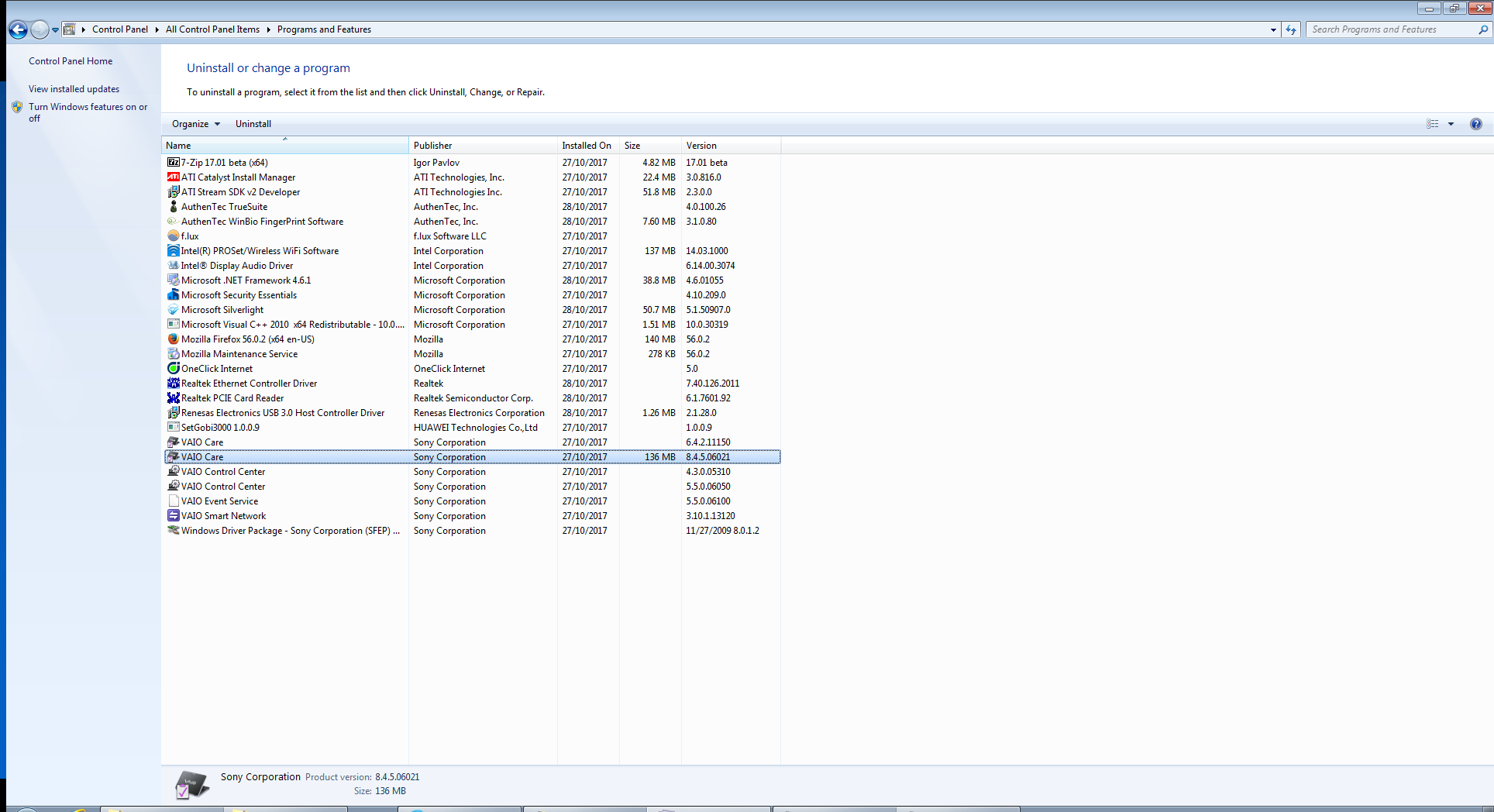

Hey quick question i have installed windows 7 pro please can you take a look at my screen shot i got 2 VAIOVcare installed is this normal ? Thanks screen shot.png
