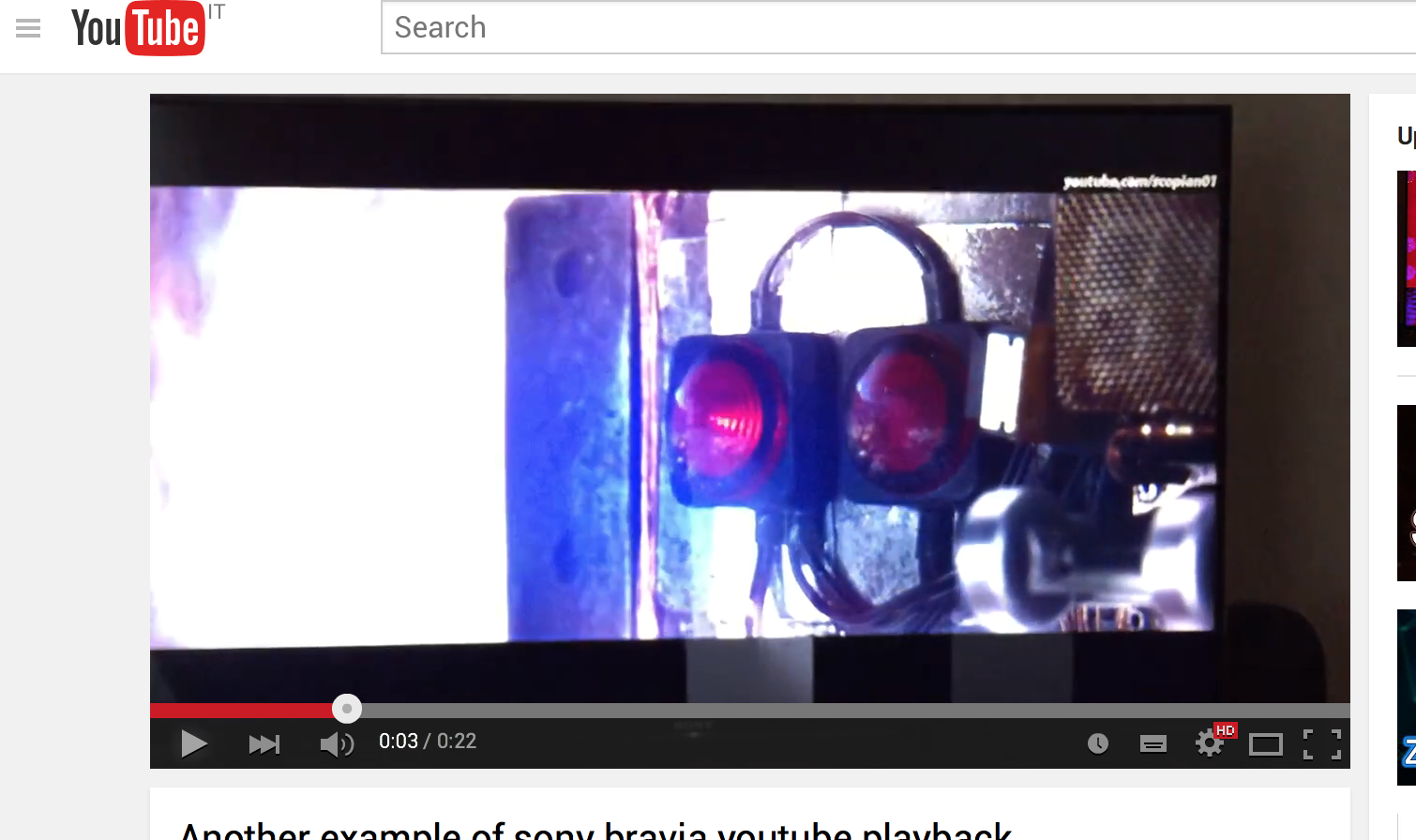

Ok got home and recorded a better example:
Here's the original video: https://www.youtube.com/watch?v=vXcFGgwP1J4
And here's what it looks like on my TV - can you see the problem now?

Hmm.. yeah, that looks pretty bad. I'd suggest to try to uninstall any YouTube update (if any and possible), but since you wrote that you already did a factory reset I doubt it would change anything. Does it happen only with YouTube? If it happens with other video apps I'm afraid the tv is defective.
Actually, now that I think about that. Try to install Kodi. It comes with an YouTube plug-in as well (which must be enabled and configured. You can also use your YouTube account). You may see if it works fine from there, just for testing purposes.
Just out of curiosity @adam_b82: if you select the HQ icon on the TV Youtube app, which resolution is selected?
