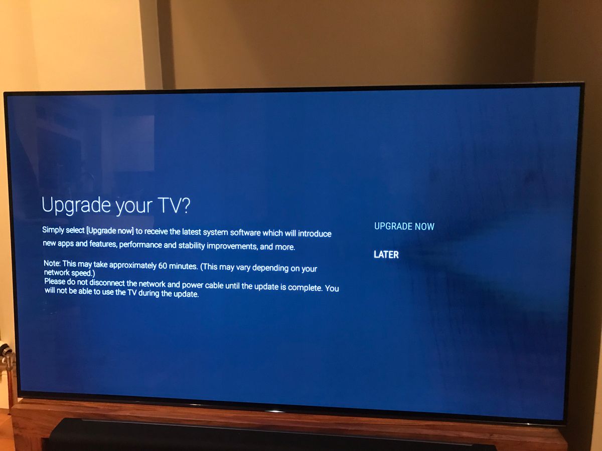

Jbmclachlan
I received the 55A1 this evening and as soon as I turned it on I could see an issue with the panel.
Right hand side .. doesn’t look good!Right hand side .. doesn’t look good!
 Fortunately John Lewis already have another on the way but a little disappointed I have to say.  It sounds a slightly different issue but just throwing it out there to share issues
