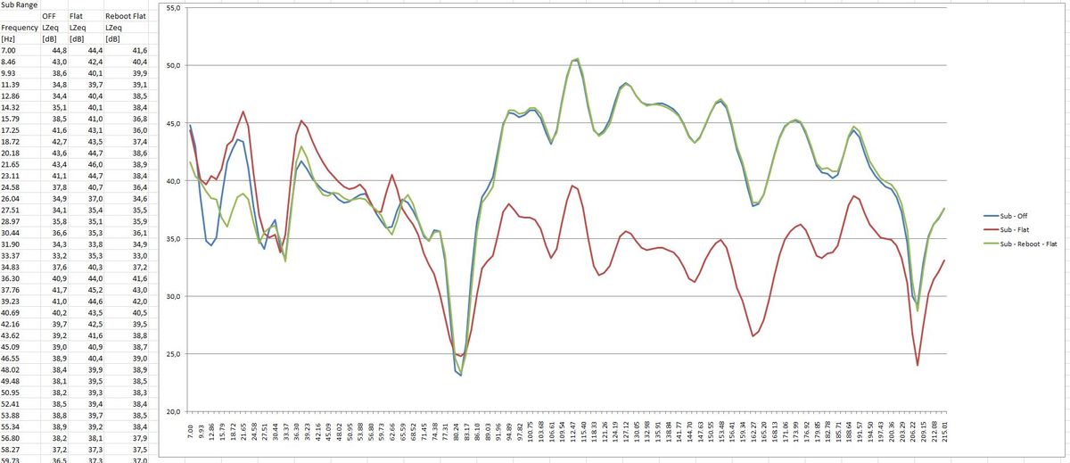

Hi,
After performing the auto speaker calibration and selecting a setting ("Full Flat" for example), this setting is not stored.
When I switch the receiver off and on again, the speaker calibration setting is ignored, although it still says "Full Flat" in the menu. The sound is as if it was set to "Off".
I need to manually set the setting to "Off" and to "Full flat" to hear the correct speaker calibration.
Thanks for your help!
Phil
193 REPLIES 193
phil_merge
Member

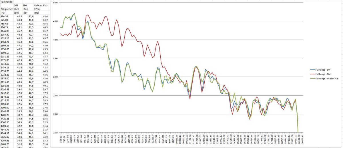

Here are the latest measurements after "clearing" for three different frequency ranges.
Blue line = "Off".
Red line = "Full flat" prior to reboot.
Green line = "Full flat" after reboot.
7Hz to 215Hz7Hz to 215Hz
58Hz to 1722Hz58Hz to 1722Hz
484Hz to 20453Hz484Hz to 20453Hz

First off, thank you both for following up on my request to perform a measurement test after clearing up the device. I truly appreciate that, as that helps ruling out any coincidental malfunction. I also had a detailed look at the results posted by Philippe and can clearly say that it doesn't look good at all. Your device fails post a power cycle to retain the calibration mode profiles. So I don't see any reason why your device would not require a repair service. You are obviously entitled to a full functioning device.
