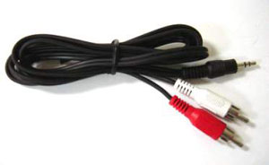

On My KDL43W653A I used the composite cable  Audi Out on the TV to the input Analog L R on my Theatre Stand together with the HDMI link
Remembering to alter the Audio output from the Sound menu on the TV.
The Optical cable would not give 5.1
