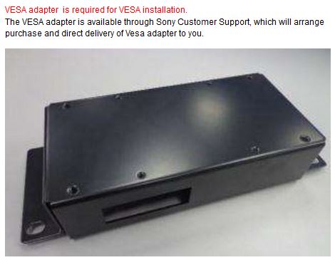

@dylanhudson has provided information in this thread on an adapter that is available to purchase direct form Sony customer service.
Dear Sir,Madam,
A ` VESA ` adapter is needed for my 50" Sony Bravia model no.KDL50W82B which I have learned is needed to adapt my tilt/ swivel wall bracket before it will fit.
