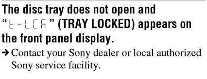

If the following is the error message you see?  If so.....It might be cheaper for a new DVD/Bluray Player - But best give contact Sony Support first: HERE
However if its this one, this may be fixable as its just a child-lock
Cheers
CeeJayH
Thank you.  The screen just says 'LOCKED' but the DVD player itself says t-LCK.  I had already tried the Child Lock instructions and it has not had any effect.  Any other thoughts?  If not, I guess I will need to take it to a shop to repair.

Ok - I found the following in a manual for the Brazillian model of the DVP-SR700HP.  Which looks like this:
On copying/pasting the text into Google Translate, I get the following:
  1. Connect the TV Unit
  2. In STANDBY mode, press the following keys in sequence on Remote Control:  TOP MENU > CLEAR > POWER
  3. Press a button : 4
  4. Press the buttons : MENU > CLEAR
  5. Disconnect Appliance (which I guess means just unplugging the power)
Then I guess test if it works.
That is everything that I could find, that relates to this error you have.
Once again - it MAY work, or it MAY NOT.  It also MAY make things worse - basically what im saying is that its up to you :slight_smile:
Good luck with everything.
CeeJayH
It is still stubbornly refusing to open!  Thank you for all your help.  I think I will have to find out how much it is to repair and decide whether it is worth doing!
