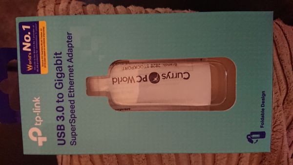

As the ethernet port on sony TV only do upto 100 mbps if I was to put a USB 3.0 gigabit ETHERNET ADAPTER into sony x94j usb 3 port and used a tp link gigabit ethernet adapter would it work.????

Hi great news fixed the Internet speed (Ethernet) I was only getting 84mbps. So I took the gamble and went and got a tp-link USB 3.0 Gigabit adapter. Fingers crossed, I put in the USB 3.0 slot on TV with ethernet cable fitted and.......... 😊 OMG it worked, I'm now running over 130mbps through ethernet... Problem solved. 😊

Interesting. So it looks a driver for the Realtek RTL8153 is included.

We only have upto 200mbps on virgin media in the 🇬🇧 UK, but what I'm getting is the same as if I was using WiFi. So I'm happy as ethernet is more stable. Loads faster now. At least it worked and people now know what they can do as a alternative... 😊
I now tried a Realtek RTL8153 based LogiLink USB3 to Gigabit Adapter on an X900F/XF90 with Android TV 9. Unfortunately does not work. So it seems to be limited to newer models. Probably a backup in case of problems with BRAVIA CORE.
Sorry it didn't work. I used a tp link plug and play.. I guess I was lucky it worked.
