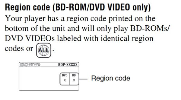

Hi there
According to:
http://www.blu-ray.com/movies/High-Noon-Blu-ray/159571/
Unfortunately I do not know anything about it being multi-region. This is in the instructions:
Cheers
