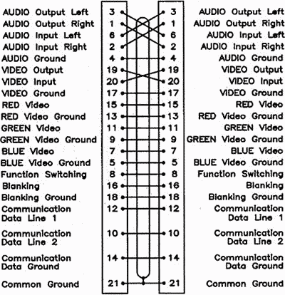

Digging even further, I decided to figure out what is a fully wired 21-ping SCART lead, and why you would need one. According to the wiring of the SCART lead (pic below), take a look at PIN 8. PIN 8 is for Function Switching.

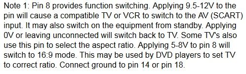

Researching what function switching means in regards to a SCART lead, gives me this:
So basically, according to the information above, to have the TV automatically switch to the correct Input source (when switching on the YouView Box), you will need a FULLY WIRED 21-PIN SCART LEAD.

Have followed your advice and it works. Thank you for your help.
