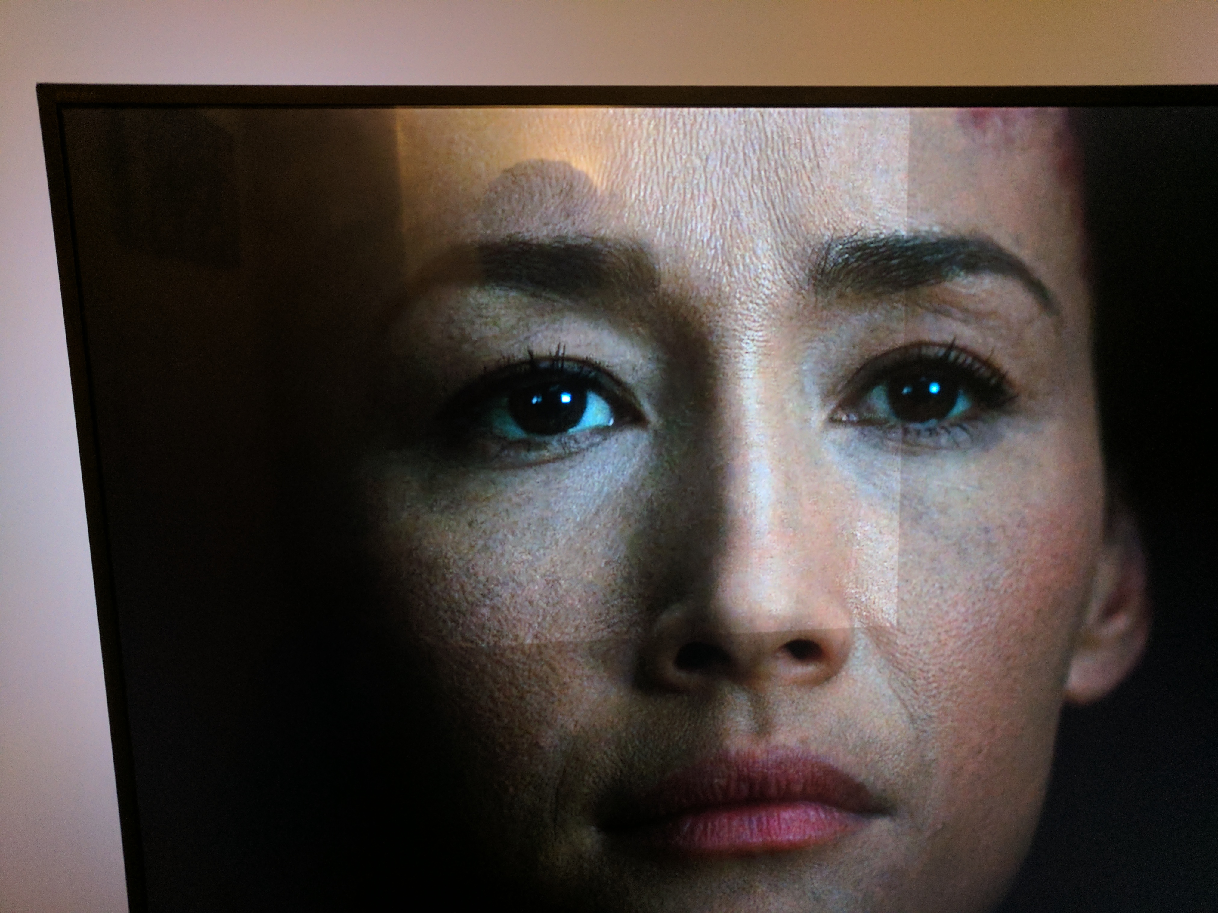

Basically, since my TV updated to Marshmallow around 2 weeks ago I've been having an issue with apps running and leaving a faded square box in the top left corner.
Sometimes it's smaller but sometimes can r half the screen.
Happens only on Apps (Netflix, Amazon, Kodi) and not on any HDMi channels.
Seems to happen possibly 80% of the time and I've not found a way for it to stop.
I've reset the TV to factory settings numerous times and also restored with current firmware that i downloaded from the Sony site and flashed using a USB stick.
Also I've ensured that all the apps are up to date via Google Play Store.
Can anyone confirm wether this is a one off in my case or wether the issue is more widespread?
I've attached a few sample images for you guys to see.
Many thanks.IMG_20170319_234053.jpgIMG_20170319_234101.jpgIMG_20170319_235356.jpg

Ouch, that is not good.  This is the first time I have heard this issue to be honest, so unlikely to be a widespread issue (famous last words...)
Question though, how long does this faded square box stay on the TV for?  Does it ever go away?
Thanks for the pics - it clearly highlights the issue.

I have a KD-55X8005C and have the same issue since MArshmallow update.  I have only noticed it in Amazon - a rareky use any other apps.  The top left corner seems to be in HD / much brighter than the rest of the screen.
To resolve I stop the play and resume. Usually fixes first attampt, but last week took 3 or 4 attemps to clear it on one occasion.
Happening on lots of different recordings - all on Amazon Prime.
