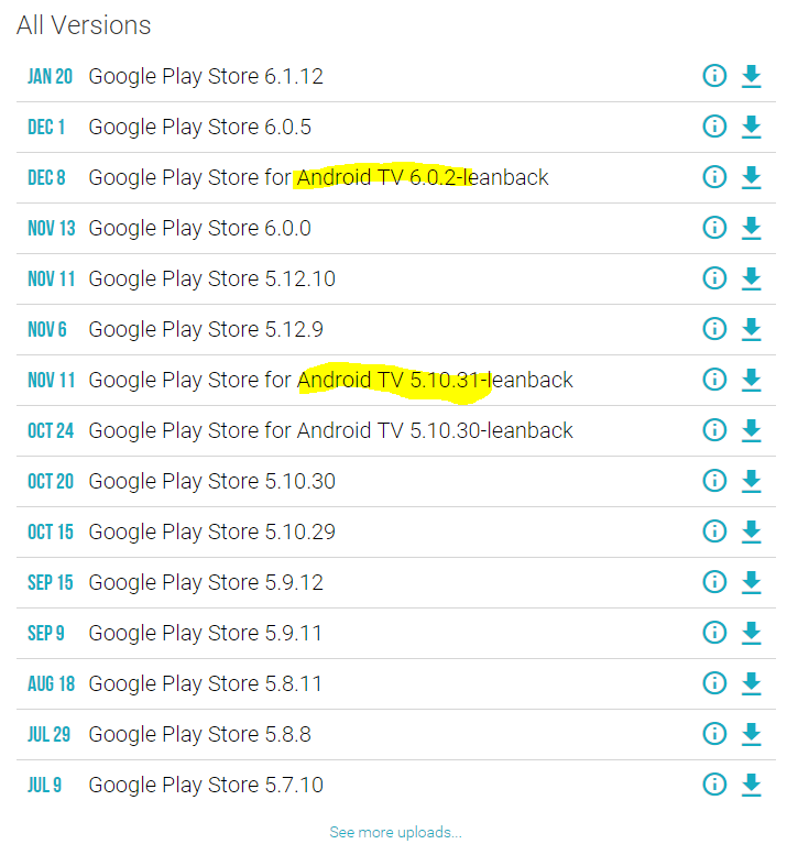

It looks that 6.0.2 leanback its the latest PlayStore version for Android TV, but if you guys think that might worth trying to downgrade to previous version 5.10.31, see how it goes and try to upgrade to 6.0.2 again.
Here you can get the apk's for PlayStore for android tv:
http://goo.gl/9znaja

you cannot downgrade. It's from the app itself because before the update it was ok with the 5.10.31 leanback
