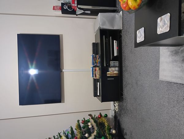

briasmit9
  •  ive no problems with space:  I overheating of x800m2 and X700.
  • Best contact Sony if things aren't what they should be for an update. They have a duty as the equipment is still being sold. Just leave gaps in installation for air to circulate.
