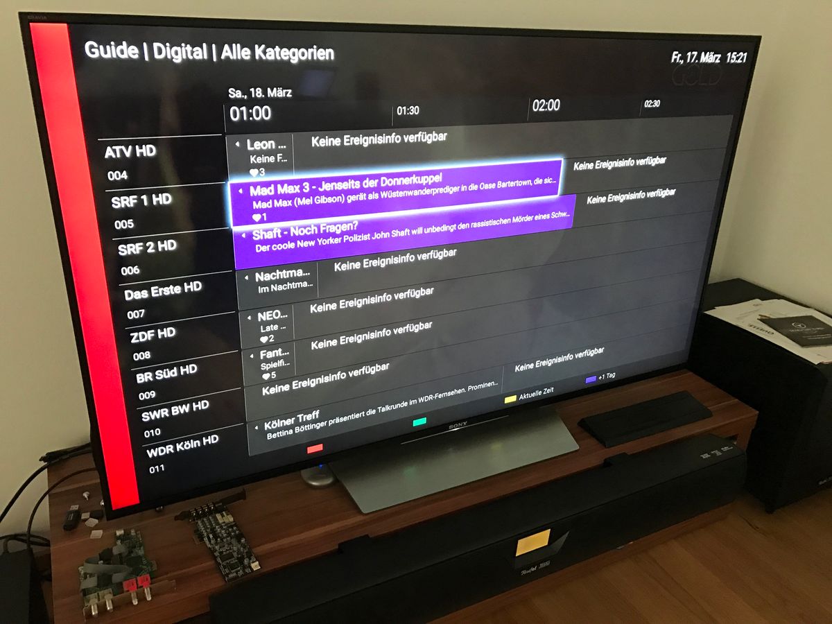

EPG fails to update is 'Auto Service Update' is disabled
Problem:
If 'Auto Service Update' is disabled then the EPG fails to update itself even if 'Update Guide in Standby' is ON. Issue present using DVB-C
Reported by:
Kuschelmonschter : HERE
Updates:
09-03-2017 - Issue reported to Sony, any updates received will be reported back.
20-03-2017 - Adding photo - in German language
